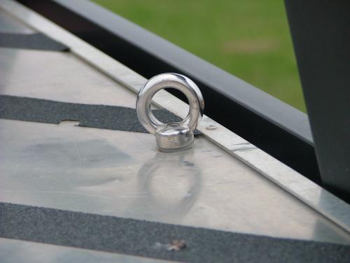

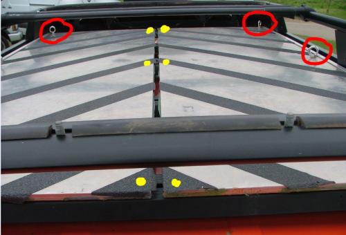

At the outer edges of the floor remove the 3 eye bolts (highlighted RED) each side. These can be undone by either putting a bar through the hole or using an adjustable spanner. bolts.
Mark a line across from each of these eye bolt towards the centre of the rack. Press down on the chevron end near the centre on the rack to find the paired mount screw (highlighted YELLOW). Using a sharp knife cut the chevron grip tape around the edge of the screw to reveal the countersunk socket screw. Remove the grip tape and remove the screw.
You can then lift the 2 floor decks.
If it is a 2005 vehicle the floors can be removed as there is not normally anything attached to the underside.

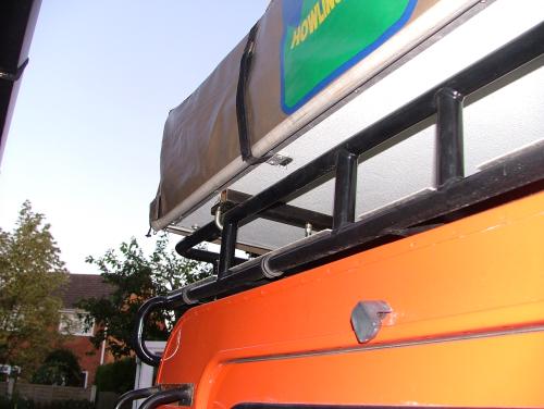

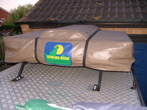

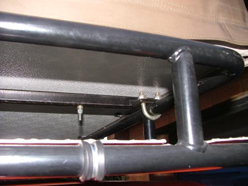

Pic below is brackets I made to do similar on my SD and Breed racks for my D1 and D110's. Yes not identical but principal is the same as I did not want to cut the rack. The brackets are held on with a 'U' bolt front and rear.
The brackets are made from 20x20x2.5mm box section. They were drilled to match the existing mounting holes in the tent floor.
Unfortunately I do not have any pics of one fitted on the RS / D3 rack.
