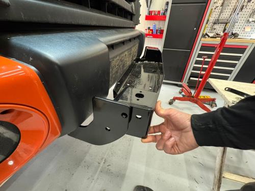

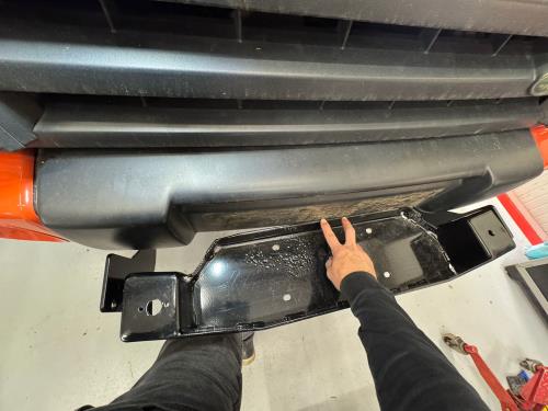

After a few years of searching i finally found a winch tray for my discovery 2 G4 event vehicle :-). When i purchased the car years ago, it was missing.
The tray got a some fresh paint and can now be fitted onto the car. Using the original installation manual for some guidelines we're almost there. But not quite.
I used the existing holes from the previous tray for fitment. The brackets do fit, but when installing the tray itself it doesn't fit with the bumper.
- Do i need to cut the bumper to make it fit (on the location where the license plate normally fits)?
- Is there someone how has a photo from original?
I'm now remaking the side brackets to make them few centimeters longer, so i don't have to cut the bumper. Any advice would be great!
Thanks! Pascal

It looks to me that is not the correct tray. Its too wide.
Here are all my parts i took off to be re-powder coated.
And you can see the kick back to the bumber here.
Might be worth double checking what you have picked up?
Ant
