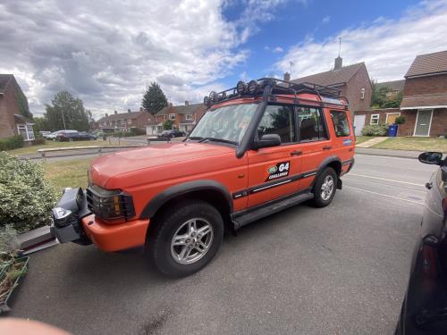

Hi All,
My names Joe, I have a g4 discovery 2 inherited from my dad back in 2020, he passed in 2018 and was a former member of the club. We went to the Grayson heritage show back around 06/07 when the clubs were competing against each other over the weekend, maybe that continued.
When I got the car I didn’t have the money to do anything more than keep it going. I can invest a bit more now and the front suspension is looking tired and old. I am looking at upgrading the shock absorbers and springs, what I don’t know is if there is any kind of lift on the car from launch, it has the winch and roof rack but I can’t find any medium/heavy load springs without a lift on them.
If anyone has any advice on this I’d appreciate it.
Thanks,
Joe
