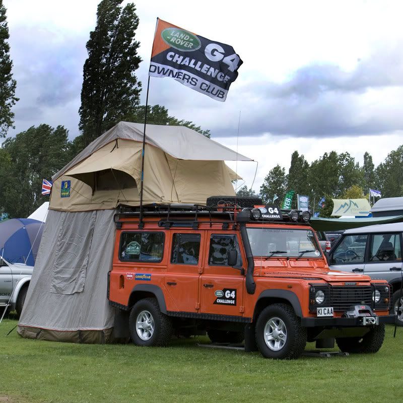

We own a G4 110 and have a Howling Moon Tent fitted. :D ___________________________________________
Kim (Born to shop.... :P) Allsebrook (aka willowkis)
I've been Tango'd
G4 110 - BV55 ZBU - Now registered as K1 CAA
Vehicle No. 112 Set-Up & Logistics Thailand & Laos

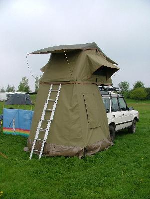

I run a Maggiolina roof tent,, and will not realistically fit the Exp rack on the Sport !! too long and too wide, even the small version ,,removal of the side bars, (if possible) as Craig suggests, may help !! It fits on the Defender just fine
I moved over to the Maggiolina, about 4 years ago, after a season in a Howling Moon,, not impressed,, flapped about in any sort of breeze, once wet, stayed wet, just soaked it up,, poor valve for money, Regards Tim

Here is a picture of ours, great tent used it in very severe weather and it was superb, bottom annex is very handy too as it gives you somewhere to change and eat if the weather is bad. takes a little longer to put up against our old Brownchurch but it has stacks of room and the built in mattress makes up some of the time. It also drys off fairly fast. 2005 G4 Defender

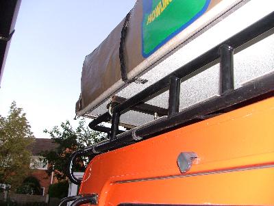

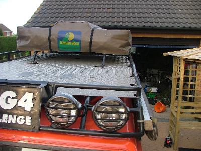

These brackets clamped to the rack using 'U' bolts.
The downside with doing this is that the tent is lifted another 125mm so raising the c of g though the D1 appeared to be affected less as it had anti roll bars fitted and OME suspension.
I too am not impressed with some of the methods some of the retailers use to fit these tents on some roofracks. They are too flimsy and protrude beyond the tent / roofrack.
If the additional height is an issue a 1.2m width of tent will fit inside side rails of a 2006 G4 style of roofrack and when bolted down can sit 30mm above the rack floor. The tent will then need to open forwards and fit inside the rack (just) though this will not allow anything else to be fitted on the roofrack. The Maggiolina rooftents are a good fit inside a 2006 roofrack but again you lose any other carrying space.
